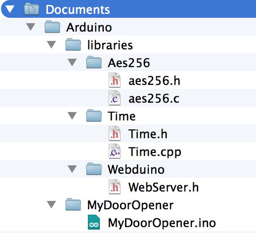

Postby support » Wed Jan 01, 2014 3:07 pm
Not sure what compiler errors you're getting (you haven't provided them in your post), but most
often (and I'm assuming here), you typically get compiler errors when the files are not in the
right location. On Windows, they indeed need to be in your "My Documents" folder, moreover,
the "libraries" folder also needs to be in the right location, containing all of the libraries
sub-folders/files that MyDoorOpener relies on. See the following Arduino forum post about this:
http://www.arduino.cc/en/Hacking/Libraries
Included is a print-screen of the folder layout for Mac OSX. It should be somewhat similar on Windows.
When you have it working, please post back so that others can leverage the knowledge which
might be specific for Windows 7.
Arduino Folder Structure (OSX)
