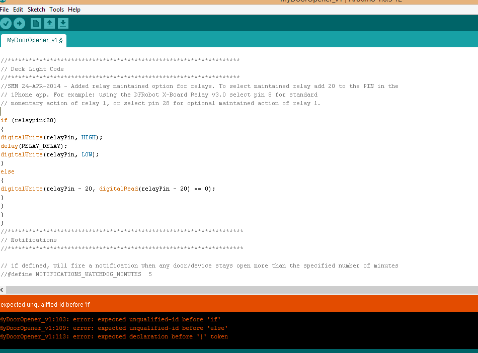

I'm trying to control a garage light to latch on, I found some code for this on this board but I keep getting a compile error? Can anyone help?
Arduino error2.PNG (23.49 KiB) Viewed 7533 times

Postby support » Thu Aug 07, 2014 7:59 pm
You seem to be having extraneous closing braces } following the end of your ELSE block ...
Each opening brace '{' should have a matching closing brace '}' ...
